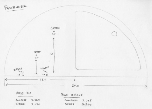

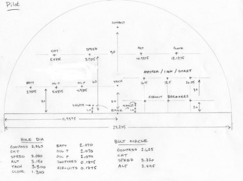

Panel Drawings
Sketched panel dimensions so I could hand off to Josiah Morgan. He will be helping me to lay this out in Catia, and then transferring the numbers to his newly fabricated, and homemade CNC router table.
Pilot Panel
Passenger Panel
