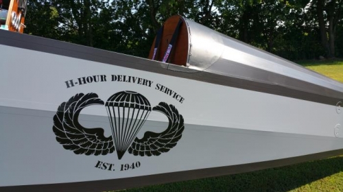

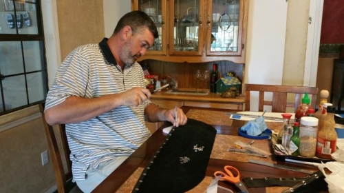

Brief Description:  Leatherwork
Working on the leather piece that will be attached to the turtledeck, just behind the pilot’s cockpit. I rolled the front edge, punched for grommets and laced. The laces really didn’t attach to anything, but give the appearance of being laced to the fabric. I used a fairly wet application of Stewart Systems EcoBond to attach to the turtledeck. That stuff seems to be a pretty good adhesive.
