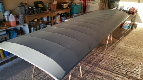

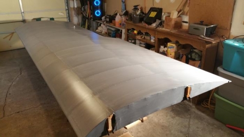

Date:  3-14-2016
Number of Hours:  5.00
Brief Description:  Paint Coat
Applied first coat of paint. I alternated top and bottom coats each day (top in the morning, bottom in the evening), applying the same as I did with the control surfaces, using a 3” foam brush and sanding with 1000 grit sandpaper after 2 coats, then finishing with two top coats.
