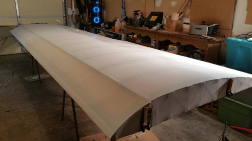

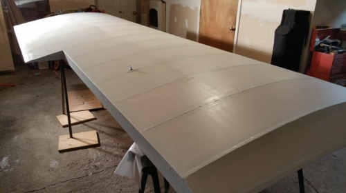

Primer Coat
Applied primer to wing using the same method as the control surfaces. Two coats applied with a 3” foam brush, wet sanded with 100 grit sandpaper, then two finish coats.
