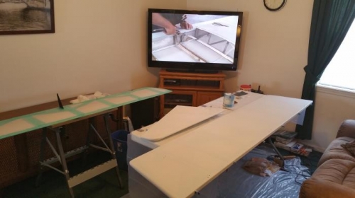

With all of the fabric work done, it was time to lay on the primer coat. I started with the vertical and horizontal stabilizers, applied 2 coats with a foam brush, wet sanded with 1000 grit sandpaper wrapped over a sponge, then applied 2 more coats, which provide good coverage with a nice smooth texture. The sanding knocked down some of the sharps (peaks) created around the pinked tape edges, and also smoothed down the initial brush strokes.
