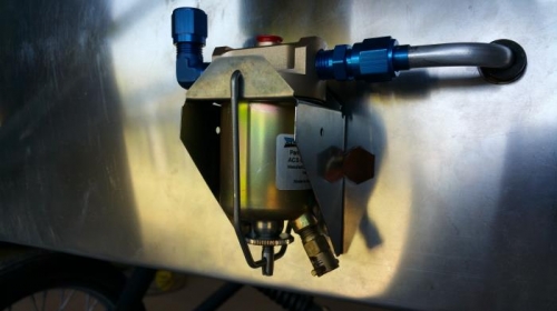

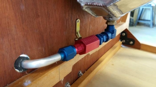

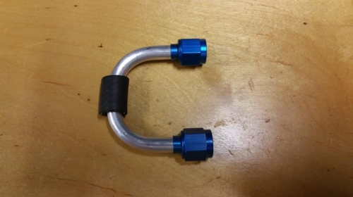

Fabricated fuel line to connect fuel tank to gascolator. My first attempt was an S-shaped line, but I didn’t like that because it left several inches of line flowing uphill (water trap), and the gascolator was positioned too low on the firewall, unnecessarily protruding below the bottom. I repositioned the gascolator and installed a short length of fuel tubing that makes a simple 180*bend from the tank to the gascolator inlet.
