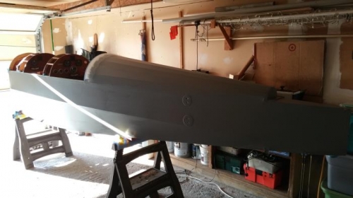

Fuselage Paint Coat
Applied final coat of paint to fuselage top and sides. This was done the same as the other surfaces, with a 2 coat, wet sand with 100 grit sandpaper, then 2 top coat system.
