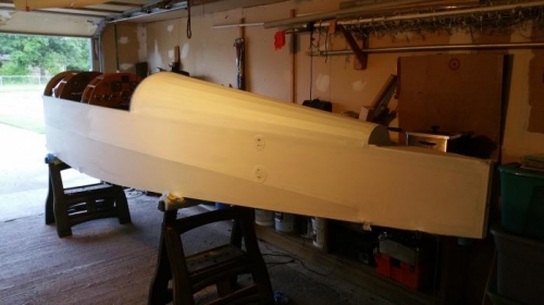

Date:  6-3-2016
Number of Hours:  12.00
Brief Description:  Primer Coat
Applied more primer to fuselage. I basically repeated the same process used on the tail surfaces and wings, using a 2” brush, sanding with 1000 grit sandpaper after 2 coats and then finishing off with 2 more coats. I did the top and sides first, but would have to flip to finish the bottom.
