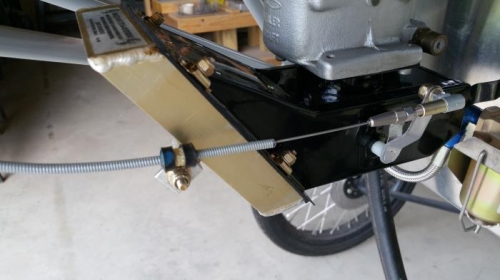

Number of Hours:  1.50
Brief Description:  Carb Heat Cable

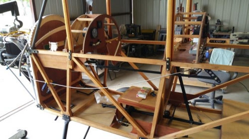

After cutting, drilling and shaping aluminum angle, I was able to trial fit the first engine control cable for the carb heat box. All cables and wiring will be installed prior to installing the fuselage sides so that proper routing can be determined while controls are easily accessible.
