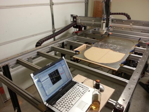

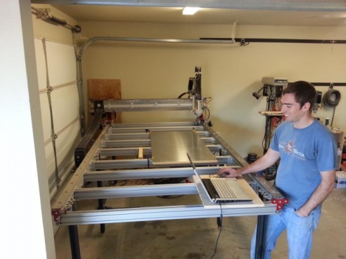

We over to Josiah’s today to cut the fuel tank components on his CNC router. Material is .050” 5052 aluminum, as recommended for fuel tank construction. We cut the components with a .125” end mill, which made for a very clean and precise cut.
Josiah Loading the Program
Jorge Cutting the Material
