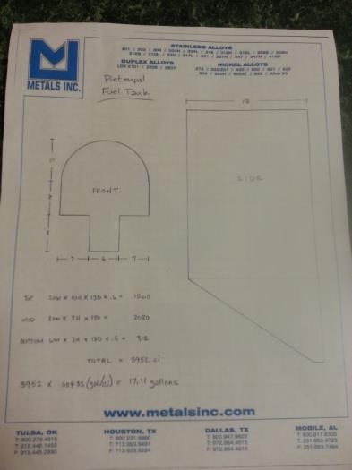

Brief Description:  Fuel Tank Sketch
I have the materials for my fuel tank, so I got started on drawing up how I would like it to look. Primary concerns were to keep the bottom sloped towards the lowest point, while making it suitable to fit in the nose of the fuselage. I was hoping to get at least 12.5 gallons (~2.5 hours flying time @ 5gph)… it appeared that I could easily do that with the available space.
