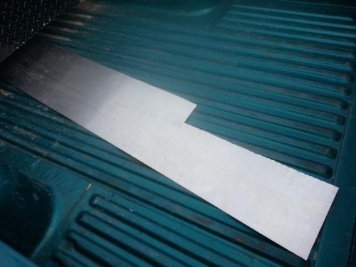

I acquired some .050” stainless from a friend that didn’t need it, which is perfect for the straps that will hold my fuel tank in place. Cut into 2” wide strips on Mike Aichele’s sheet metal sheer, this fabrication was relatively easy. They wil be lined with felt at a later time.
.050
.050" stainless

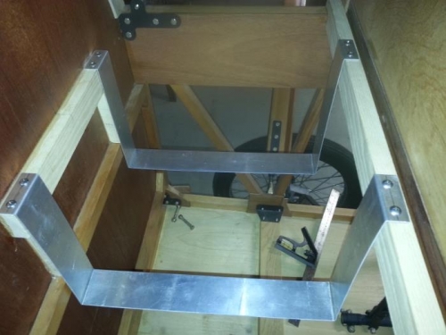

Cradle for Fuel Tank
