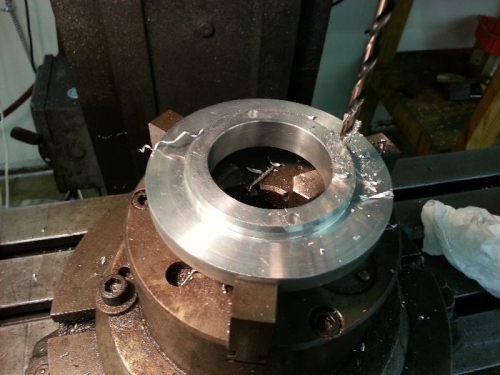

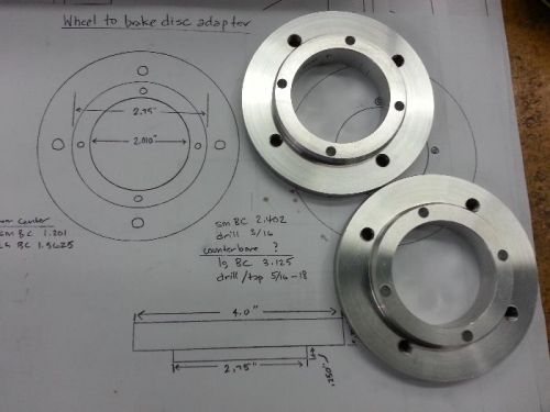

Now that I have my brake discs (8" go kart brakes), I can drill the mounting holes.
