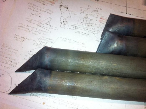

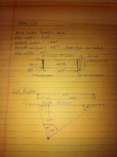

I built the landing gear jig a while back, but I've been somewhat intimidated by the thought of shaping and fitting the tubing. I got started on some of that tonight by flattening the tube ends where they will mount to the fuselage fittings. Also had to figure out how much axle was needed to mount the wheels.
Flattened and angles cut
