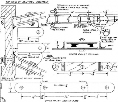

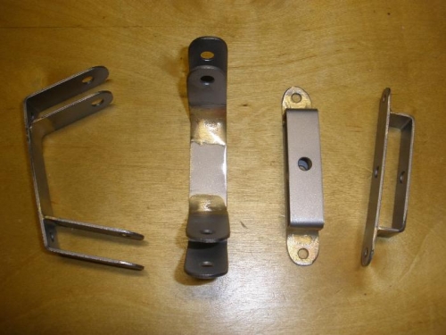

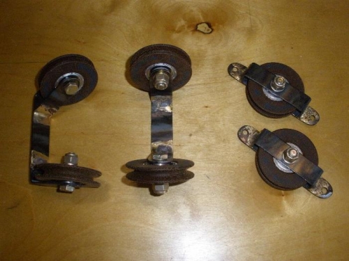

I spent the last few evenings over the long Memorial Day weekend fabricating the aileron control pulley assemblies. I fabricated all the metal parts on Friday evening, tried my hand at brazing Saturday night, which went good... then sand blasted and painted them on Sunday. Should be getting them mounted on the wings and center section soon.
All these assemblies were a little intimidating on the front end, but as I break it down and work in steps it doesn't seem too bad.
Plans
Plans
All Assembled and Looking Good
Ready for Paint
Ready for Paint
