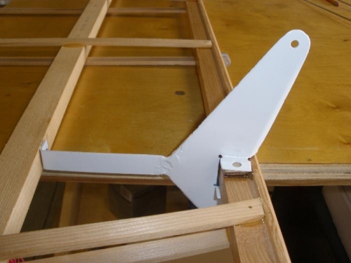

I've been working on and off lately... we've got a Learn to Fly Day event coming up on the 21st that has been taking up some of my time, and the weather has also been kind of bad lately, but I have managed to get the steel control horns fabricated and painted.
They aren't perfect, but they are good and strong. I did ok with the torch, but did manage to blow a few holes in the thin material, which required me to feed in some filler to make a patch here and there.
All Painted Up and Ready To Install
Elevator Trial Fit
Elevator Trial Fit
