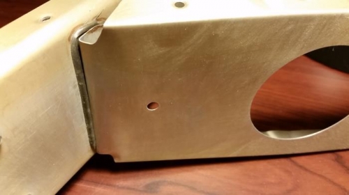

Tonight, I began to refamiliarize myself with the vertical stabilizer. I grabbed the vertical stabilizer which was built years ago. (This is my second; I build the first one as one of the first parts I attempted, and dimpled it too deep and created tiny cracks in the skin, ribs, and spars). While examining the vstab, I noticed that there was delamination of the center rib to the front spar. I emailed a picture to Skeeter, and he recommended drilling out any joint in similar condition and reappling ProSeal and re-rivet.
