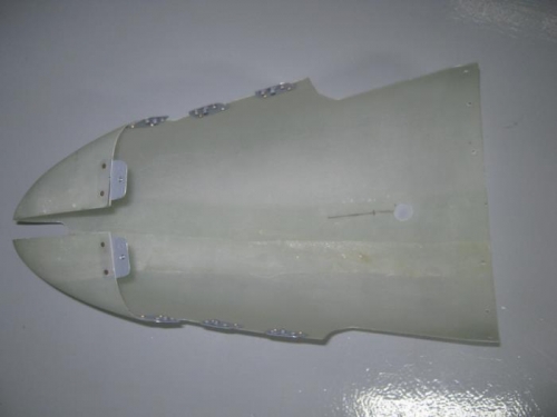

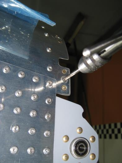

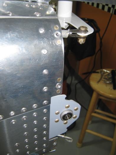

Locate and attach nut plates to designated locations on the tailcone assembly for tailcone fairing attachment.
Nut plates attached
Tapped the designated nut plate per instructions in Step 3
Located hole in lower tailcone fairing per Step 7. After fitting, needed to elongate hole 1/2"
