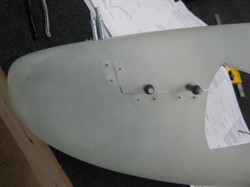

Match drill middle hole on upper portion of F1294-C tab for nut plate location

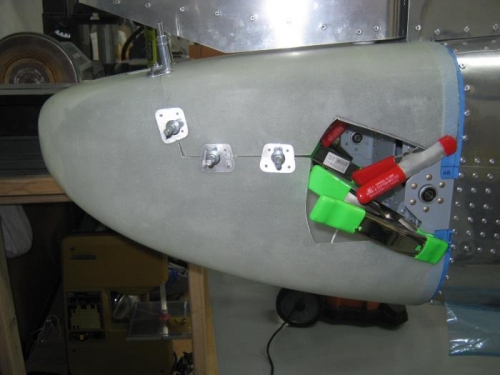

Tailcone temporarily mounted on left side for match drilling for 1294--C nut plates
View of right side

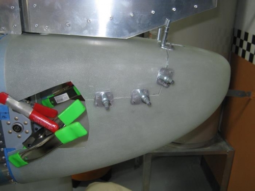

Final drill to #27 nut plate holes
