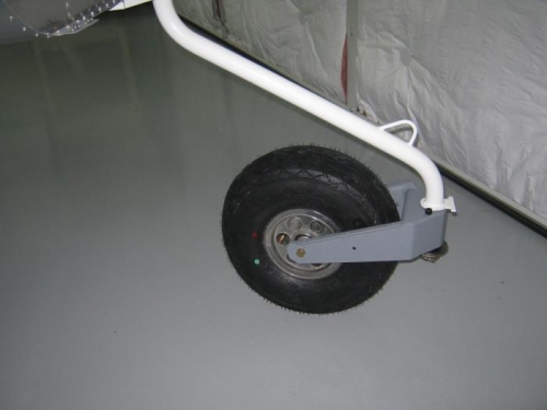

Installing the nose fork nose wheel entire assembly

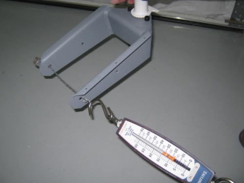

Set the turning tension on the nose fork to 18-20# per spec
Nose wheel installed

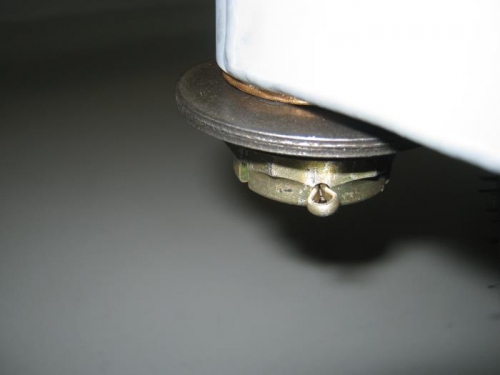

Match drilled and installed crown nut and cotter pin
