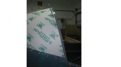

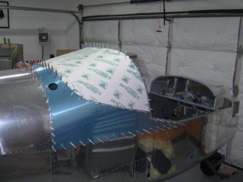

Installing the turtle deck
Cleco'd the right and left turtle deck skins to the fuselage and tailcone assembly
Cleco'd the aft window underneath the turtle deck skins
Match drill the 3/32" holes from the aft window into the rollbar frames
