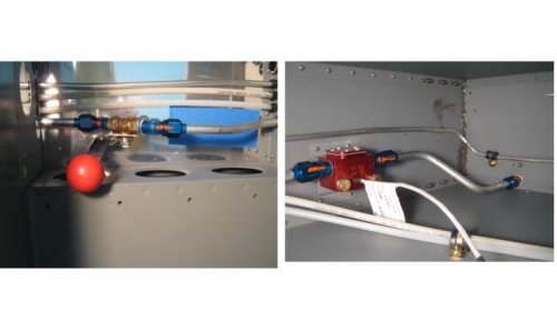

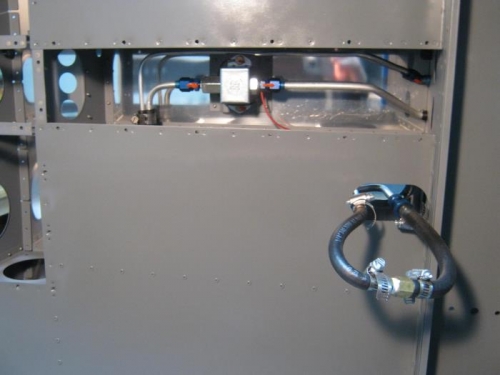

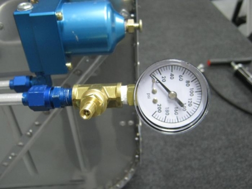

Ran pressure test of fuel system lines
Found a few leaks due to insuffient torque on the fittings
Torqued to specifications and re-pressurized at 6# psi
Held pressure for 24 hours
Attached pressure guage to gascolator and pressurized system
Torqued fittings and mariked with torque seal
Closed fue line circuit for pressurization
