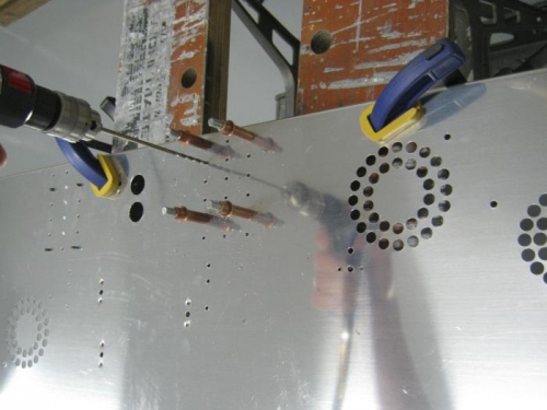

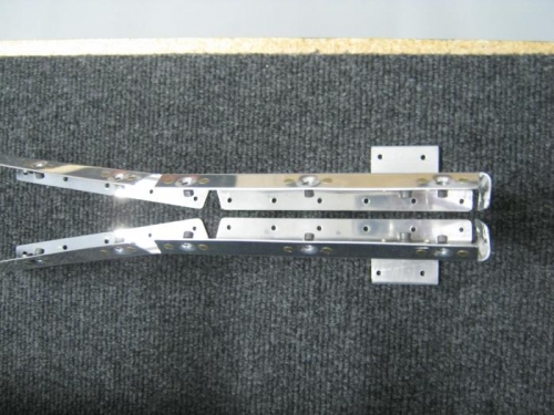

Completed match drilling #30 holes in longerons
Match drilled holes common to panel base and canopy ribs
Final drilled #30 holes common to the engine mount brackets and the panel base
Match drilled canopy rib attach angle with panel base
Match drilled engine mount brackets to panel base
