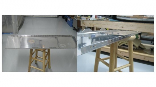

Attached nut plates to F1202B panel base

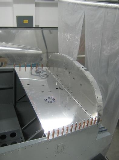

Clico'd the F1202 panel base to the F1201A firewall upper and match drilled #30 the holes common between the panel base and the longerons
Panel base nut plates installed
Fitted panel base to upper firewall and aligned with longerons and match drilled longerons
