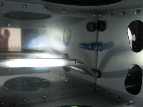

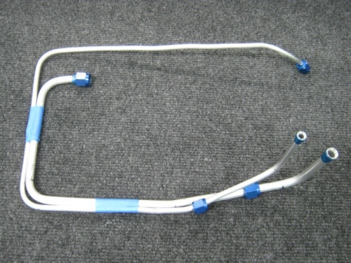

Created fuel return line

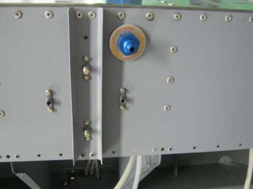

Installed fittings for forward bulkhead and center section bulkhead
Installed the AN837-4D bulkhead fitting to the center section bulkhead
Attached the AN832-4D union bulkhead fitting to the F1201B firewall shelf
Created the fuel return line and attached to the F1259F fuel line tank pump for practice fitting
