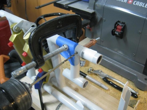

Final drilled attach holes for brake pedals

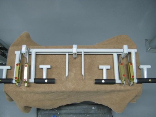

Assembled rudder pedal assembly, including all attachment hardware

Final drilling; Wow! This was difficult drilling these holes in steel, detroyed a 1/4' bit. had to go get another one. Caution Note: As the book said and I conveniently forgot about, make sure the torque tube assemblies for the brake pedals are facing the correct direction.
Match drilled #30 hole.  followed up with #12 all the way thru and 1/4
Match drilled #30 hole. followed up with #12 all the way thru and 1/4" to complete

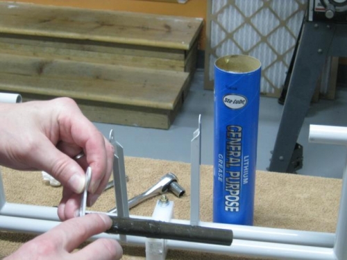

Greased brake pedal torque tubes prior to assembly
Rudder pedal assembly complete; ready for installation
