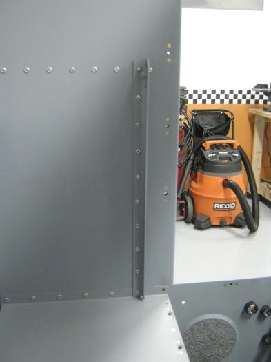

Machine countersink the nutplate attach holes in the top of the F1207J attacj amgle
Rivet the nutplate to the top of the F1207J attach angle
Cleco the rivet the F1207J attach angle to the F1207C-R baggage bulkhead, F1207K brace angle and F1224R baggage floor

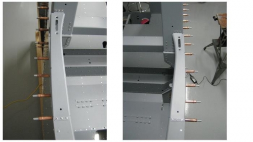

Rivet the F1254L & R support frames to the rollbar assembly and F1234L & R canopy decks
Riveted the nutplate for the F1207J attach angle
Riveted the F1207J attach angle to the rear baggage bulkhead
Riveted the L&R support frames to the rollbar
