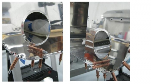

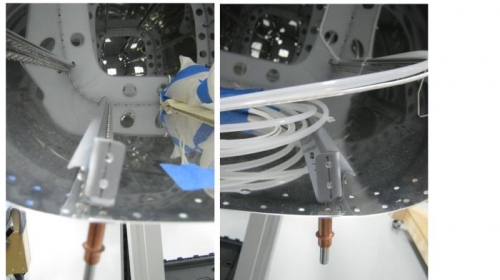

Match drilling shear clips in the tailcone assembly
Cleco'd the F1207C left and right baggage bulkheads to the tailcone assembly and match drill #30 holes
Match drilled the #30 holes on the shear clips
