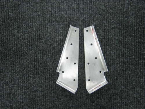

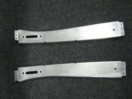

Trimming support frames and prepping rollbar brace brackets and primed parts

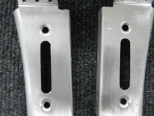

Removed hatched areas from F1254 L&R support frames. Cleaned and deburred
Dimpled holes in support frames for the head of a #8 screw
Separated, cleaned and deburred rollbar brace brackets
