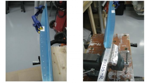

Finished the left longeron; began and completed the right longeron

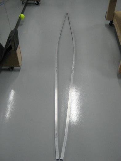

Adjusted F1255 L & R longerons to match curve of template

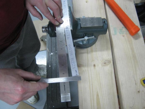

Verified final bend equaled 4 degrees per figure 2
Completed left and right F1255 longerons
