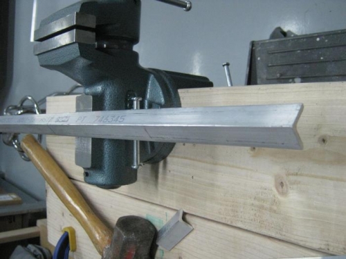

Cut the longeron to length and used the removed pieces to practice hammering the angle to increase it by 5.4 degrees.
Began creating the longeon curve between 23" and 43.75" (lots and lots of adjusting on this one; not a quick job)
Prepping longeron for hammering

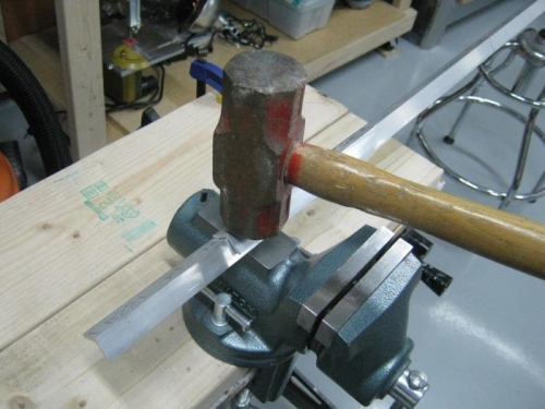

Hammering the longeron

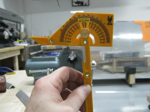

Opened the angle of the longeron per Fig 4 by 5.4 degrees
