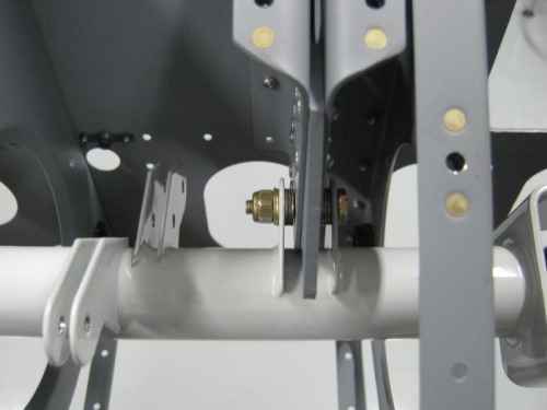

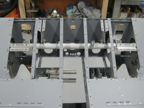

Step 1
Install control column
Torqued attach bolts to 25 inch pounds
Control column installed, center view
Control column attached to control column mount-left side
Control column attached to control column mount-right side
