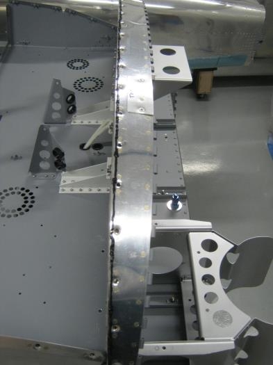

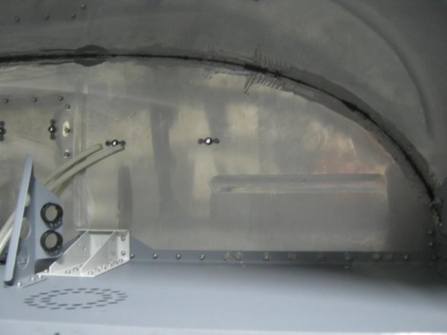

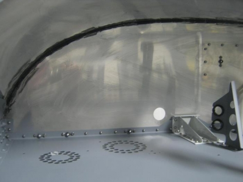

Seal avionics bay at F1201H Upper Forward Fuse Doubler and F1240 Upper Forward Fuselage Skin Interface.
RELEASE DATE 12.12.2013
F-1201H Upper Fwd Fuse Doubler ready for application of sealant
Sealant applied. View from aft firewall; right side
Left side
