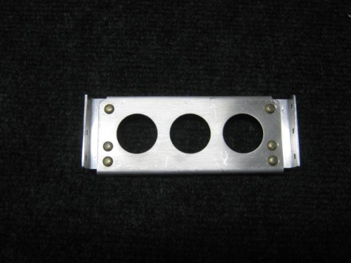

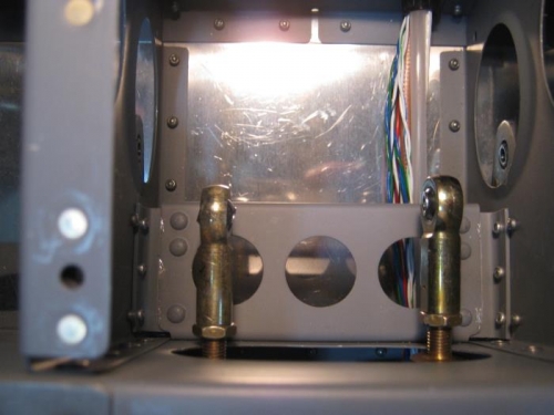

Brief Description:  Cracking F1206F Bearing Bracket Brace
Inspect for cracks in the area around the aft rivet in both side flanges of the F1206F Bearing Bracket Brace. The presence of cracks requires the modifications described in this document. If no cracks are present, make a log book entry indicating compliance with this service bulletin and date of next inspecition (if applicable).
DATE RELEASED 12.31.2014
Replacement F1206F prepped and ready for installation
F1206F bearing bracket brace installed.
