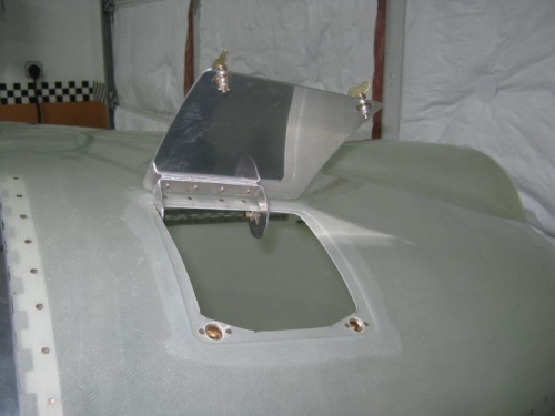

Install attach receptacles in the recesses of the upper cowl oil door opening
Attach cowl door assembly to the upper cowl

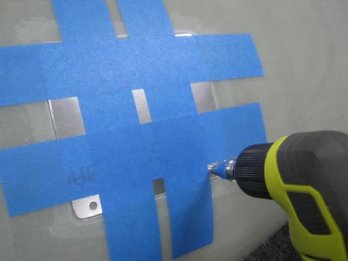

Step drilling 1/4' holes for the attachment receptacles

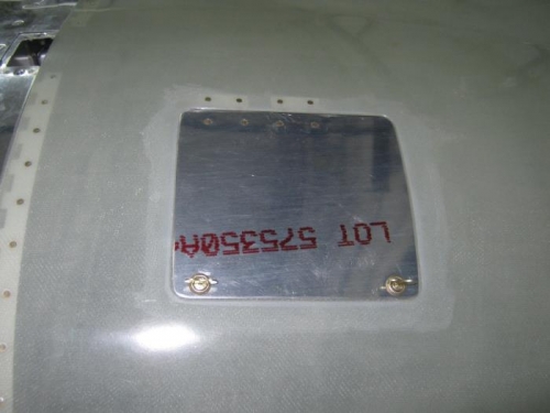

Oil door fit and attachment hinge riveted in place
Testing fit
