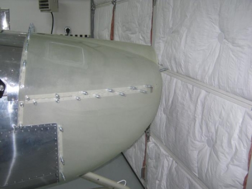

Drill then cleco the remaining holes through the top cowl and upper cowl hinges, starting at the inboard holes, working out.
Upper cowl hinge location holes drilled-left side
Right side.
