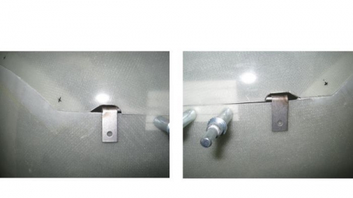

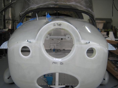

Steps 2-4 Drill throughhe most inboard hole in fig. 1 and cleco in place Mark location of cowl hinge pin and knuckles on the top cowl and bottom cowl Remove cowl and create a notch for the knuckle Drill then cleco the two remaining forward hole locations on each side of the top and bottom cowl
