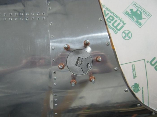

Temporarily install fuel tank and fuel neck assembly.
Center the fuel neck on the skin fuel opening of the forward turtle deck skin.
Once satisfied with the fit, match drill #30 holes in the turtle deck skin.

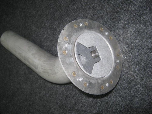

Match drill and install the nut plates holes in the fuel neck.
Fuel filler neck postitioned and attachment holes drilled.
Nut plates installed on the fuel filler neck.
