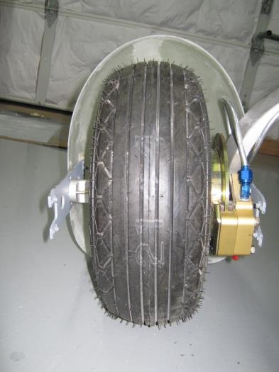

Brief Description:  Modifying wheel fairing halves
Steps 2-4
Left side
Attach wheel fairing aft on the U-00002 wheel fairing brackets, using clecos.
With a fine point pen, mark the U-00001B wheel fairing aft along the aft and outboard wheel opening, so that the distance is the same as that of the inboard wheel opening.
Remove wheel fairing and sand to the trim line.
Re-attach the wheel fairing aft on to the wheel fairing brackets.
Attach the front to the U-00002 wheel fairing brackets and the U-00001B wheel fairing aft.
Use a fine point pen to mark the wheel fairing front on the outboard side where it meets the wheel fairing aft wheel opening.
Continue marking along the outboard side and the front of the wheel opening to create the approx. 1/2' wheel clearance.
Remove the wheel fairing front and trim/sand to the trim line.
Reinstall wheel fairing front and check the clearances.
Attach wheel fairing front to brackets and check the clearance.
