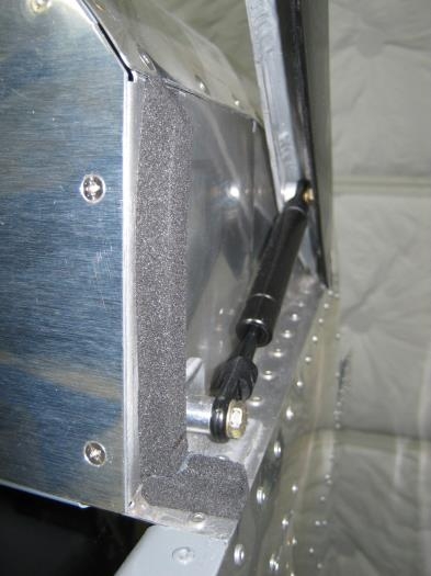

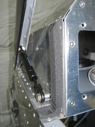

After attaching the vertical and base seal, trim the upper end of the vertical seal per drawing.
Close the canopy after the seal adhesive is cured and mark the foam adjacent to the bottom of the .125 thick aluminum plate which is part of WD-1219 canopy frame.
Opent the canopy and slit the F-00059B vertical seal horizontally at the mark appox 1/8' deep to allow the bottom of the vertical seal to remain at full thickness, thereby filling the gap.
Left side foam seal installed and horizontal slit created
Right side
Right side
