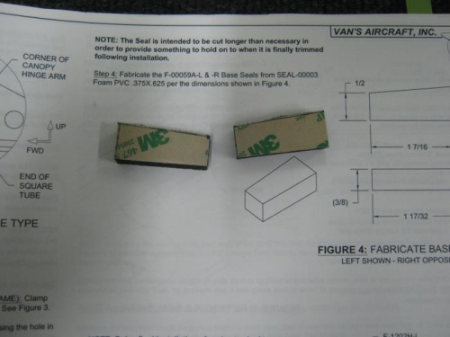

Fabricate the F-00059A left & right base seal.

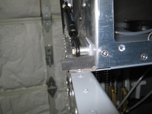

Temporarily position the base seal onto the F-1202B panel base and place a reference mark on the fuselage side skin at the location.
Seals cut
Seals cut
Left seal temporarily installed; reference mark located
