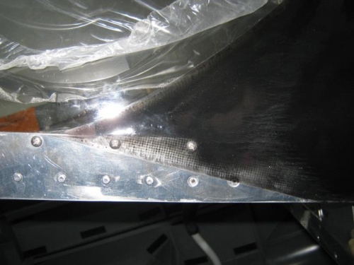

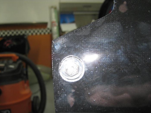

Drill hole through glass fabric layup at location of canopy pivot bolt.
Carefully enlarge holes to 3/16'.

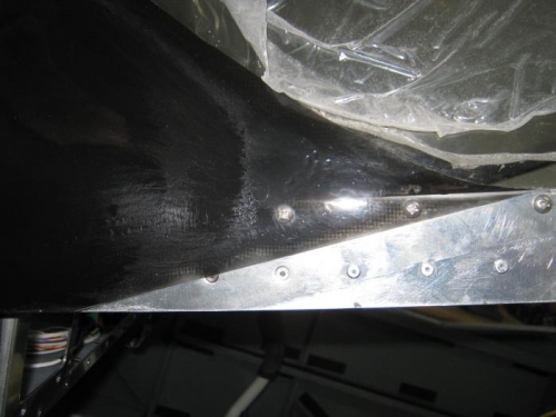

Re-drill three holes where screws were removed from the canopy skirt and reinstall the screws, washers and nuts.
Canopy pivot hole drilled
Left side screw holes drilled and reinstalled
Right side
