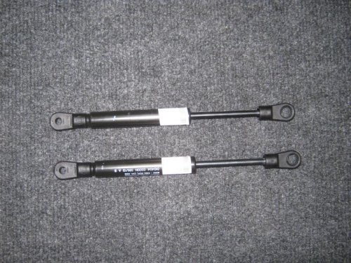

Brief Description:  Canopy lift struts
Steps 1-2
Prepared canopy frame and lift struts for installation.
Sanded the weld in center of canopy frame front bow such that is protrudes not more than 1/32' above the basic tube
Attached gas struts to the canopy frame
Trimmed the ends of the gas strut attach screws such that only two threads are protruding beyong the end of the nut.
Drilled to final size, holes in struts
Match drilled holes in canopy frame
Sanded down front canopy bow weld
