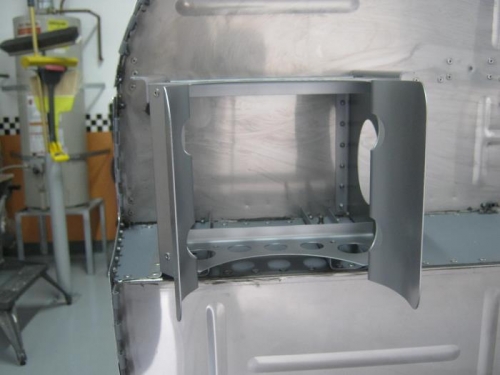

Oil Tank Mount Brackets
Cracks have been found in the F1201E L&R Oil Tank Side Brackets per drawing. Installation of an extra F1201G-MOD Rib is required to prevent cracks in this area
RELEASE DATE 4.5.2013
Installed lower reinforcement bracket
