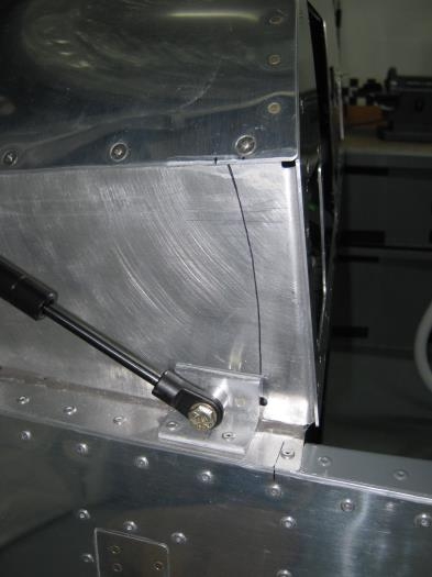

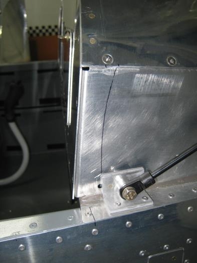

Steps 8-10 Determine the location of the footprint of the C-1217A forward seal on the F-1240 upper forward fuselage skin by placing roll of soft modeling clay parallel to the forward and aft edge of the skin. Use template to locate seal position and mark reference line.
