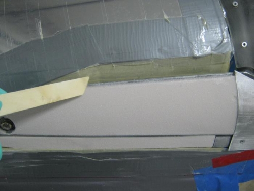

Cut away the thin edges of the C-1208 canopy foam along the upper edge until there is a shell approx 1/8' wide
Mix epoxy and thicken with flox to create a paste and fill the just created gaps with the thickened resin mixture per callout
Applied resin to the upper surface of the foam block
