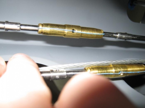

Configuring cable connections and tensioning cables per specifications-35-45 inch pounds

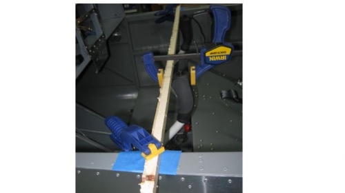

Sertting control stick10" from panel prior to cable tensioning

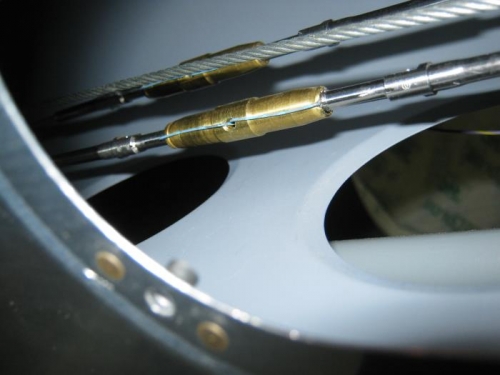

Lower stabilator cable secured and tensioned to 45 inch pounds
Upper stabilator cable secured and tensioned to 38 inch pounds
