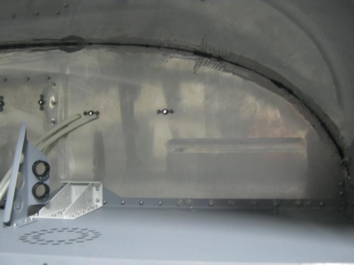

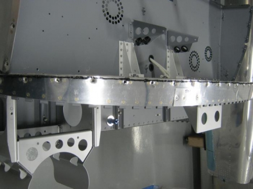

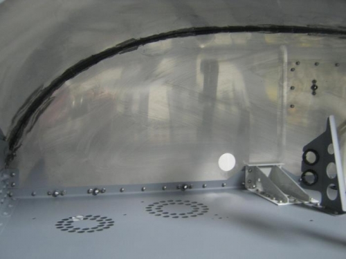

Brief Description:  Sealing Avionics bay to prevent water intrusion
Removed F1240 upper fuselage skin panel
Applied 1/4" radius of Permatex 16BR Black Silicone adhesive across the entire forward span of the F1201H upper forward fuse doubler
Applied sealant to the F1201H upper forward fuse doubler
