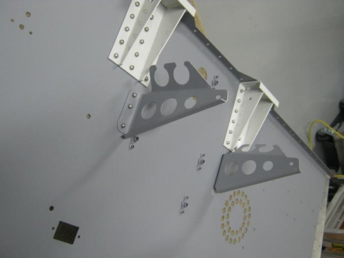

Final drill #30 all rivet holes in the WD1204 engine mount brackets and rivet them to the web of the F1202B panel base
Rivet the F00026 inst stack angles and the F00027 com supports to the F1202B panel base
Slit 4 SB750-10 snap bushings and insert them in the forward flanges of the F00027 comm supports

Installed nut plates on F0026 stack angles
Installed nut plates on stack angles- front & back view
Final drilled and riveted #30 engine brackets
Riveted F00027 comm supports to panel base
