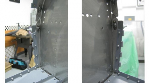

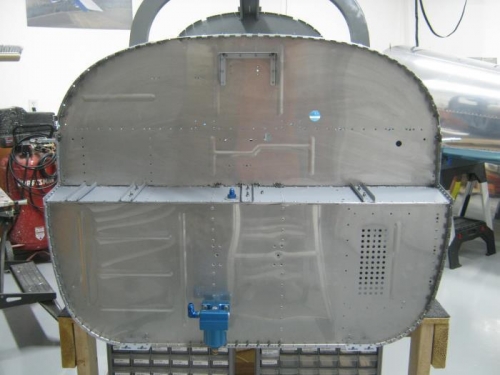

Attached upper firewall & side cowl skins
Applied fuel tank sealant to lower flange of upper firewall
Riveted upper firewall
Match drilled and riveted the F12116 L&R cowl hinges to the F1201P firewall spacers & F1270 side skins
